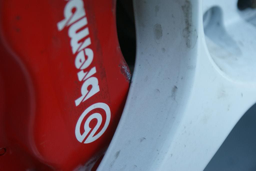

hey guys ive recently fitted brembos to my evo 4, but have a problem!
ive got 17x8" et 35 wheels and theres not enough clearance from the brembos because of the style of spoke!
anyone know where i can get approx 3mm wheels spacers or has anyone got any for sale going cheap? i dont have £60+ tho for these
heres the shot of the wheel with caliper.

a 3mm spacer will be ok with the normal studs but any more than that and its not too safe IMO...:handsup:
I took my GTR's off due to having to run a 6mm spacer...:wallbang:

Wasn't there someone on here who ground a small bit off their calipers to give a bit of clearence? Wouldn't be my first choice but could be an option.
281 Posts
I've seen this done before aswell - a would NOT recommend doing so, very unsafe. Brembo make their calipers to high tolerances, shaving a few mm off may only seem small but the combination of heat/pressures/vibrations etc could cause the caliper to crack.
Just buy some spacers or get your local machine shop to make some up - they shouldn't be too expensive.

you need wheels with an offset of 38. you could get a set of evo 5 standard wheels:smthumbup
