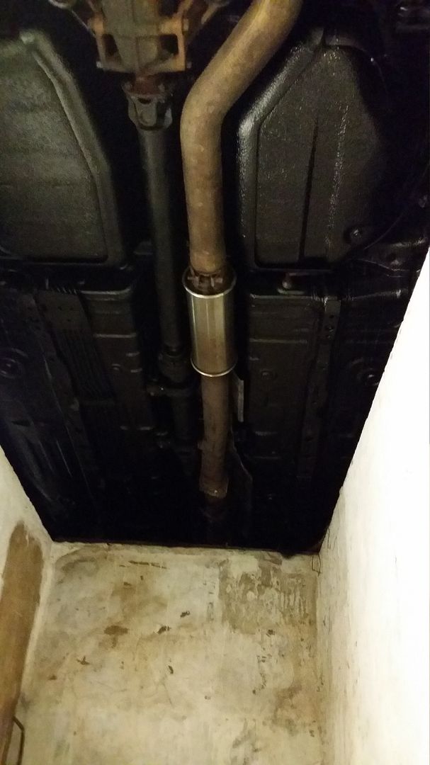

i like what you did underneath alot
Thanks :)

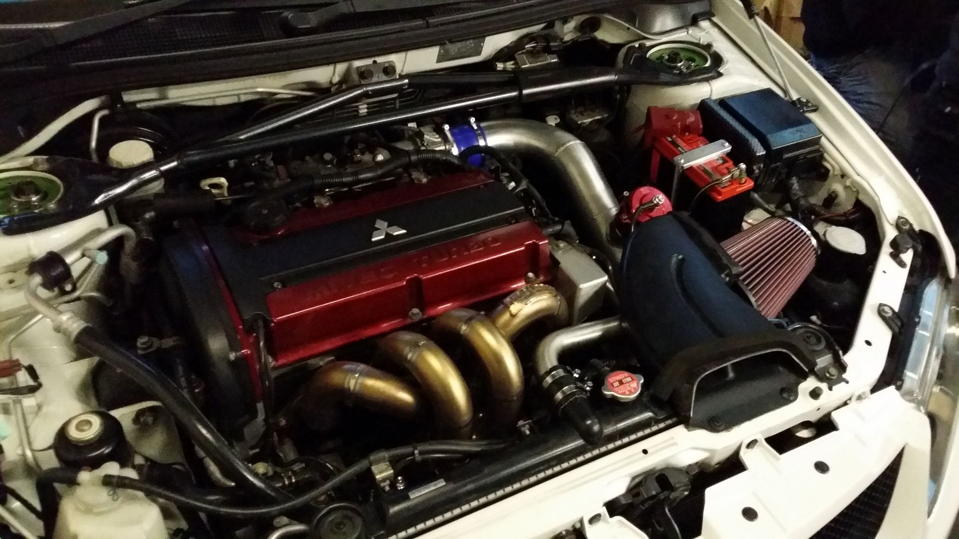

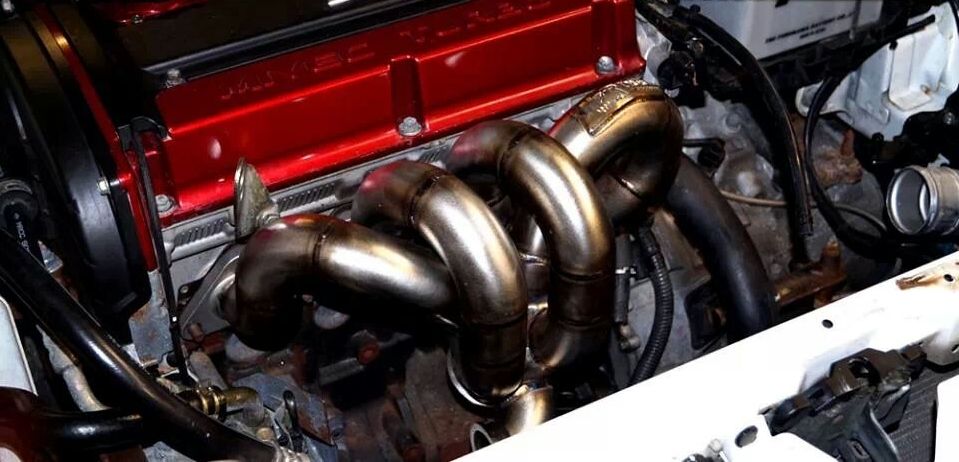

So my car's been away for 2 weeks now having a turbo kit developed, here's a sneak preview before I go and pick it up tomorrow after it's been mapped on low boost.
- Owen Developments GT3076HTA-M Turbo with the new Garrett V band .63 exhaust housing
- Tial MVR 44mm external wastegate
- Tial BOV Q
It's also having a full intercooler kit using a Garrett core
And an Odyssey race battery kit
Can't wait to see it complete :D

Well it made 420bhp at just 1 bar of boost! Injectors are maxed out now otherwise they coulda gone further. Goes well though, very very strong top end and it's just relentless until the red line.
I'll scan the graphs in tomorrow.
I only got one pic today, stole the other two from Nortech's facebook page.
Would like to say thanks to GR Performance for the mapping and Alan (Ruddy), James and the rest of the team at Nortech, it's awesome :)
