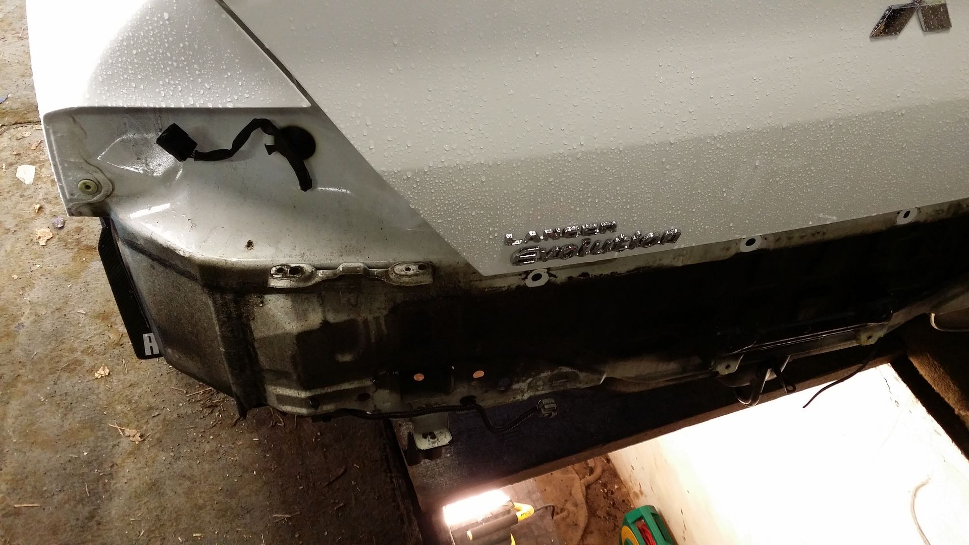

A busy weekend for me and Michael (F1 MSN) as we undersealed both our cars. I'm sure Michael will update his thread in due course too :thumbs:
I wanted to check my rear panel so off came the rear bumper, and although a bit dirty it was pretty clean, only a small area needed attention which you'll see in the later pics.
Fortunately my car has been done before and contrary to my first thoughts, it was very well protected and very clean underneath but needed a freshen up in a few places :)
So got the degreaser out and cleaned all the cavity wax off from everywhere. One of the box sections by the bootfloor was quite bad so that got wire wheeled back and treated.
Other side was very clean
Heat shield surrounding the fuel tank cleaned up
Everywhere else degreased
Any bare metal areas primed with a red oxide primer
Our choice - 3M Underbody Schutz
Car was then sheeted over and masked up. And here's the finished product.
BIG thanks to Michael for his help this weekend!
