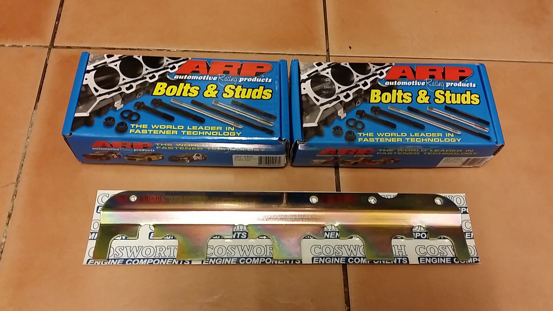

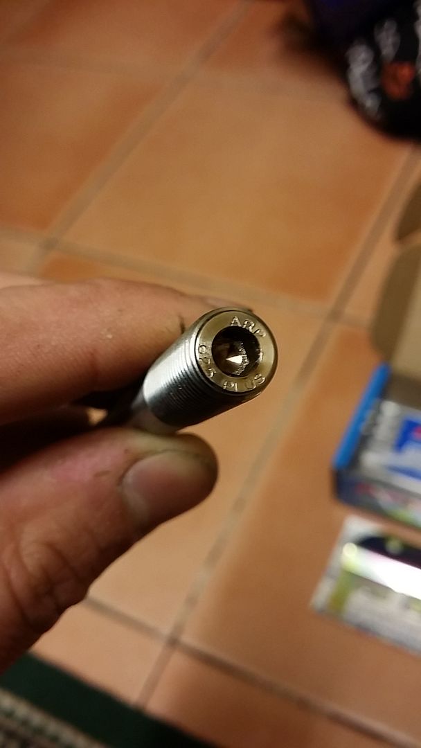

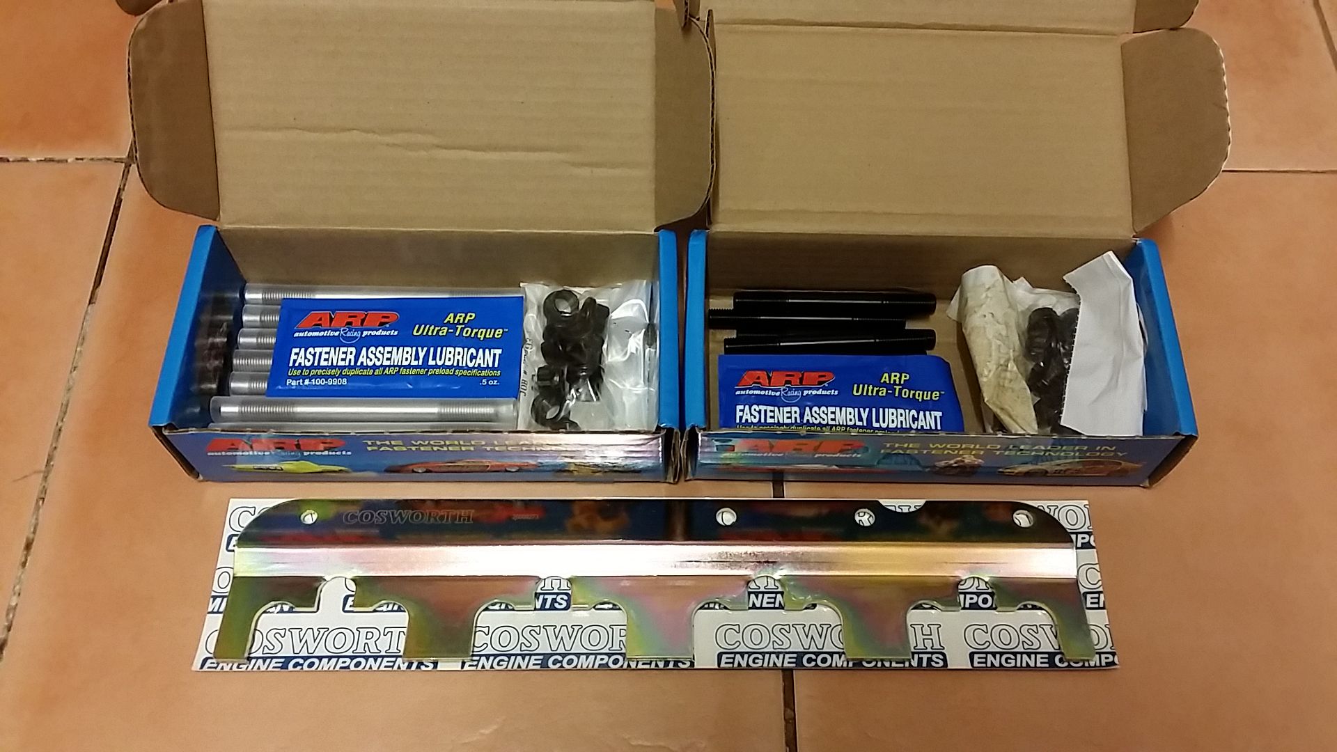

Few more bits for the build
ARP CA625+ head stud kit
ARP main stud kit
Cosworth crank scraper

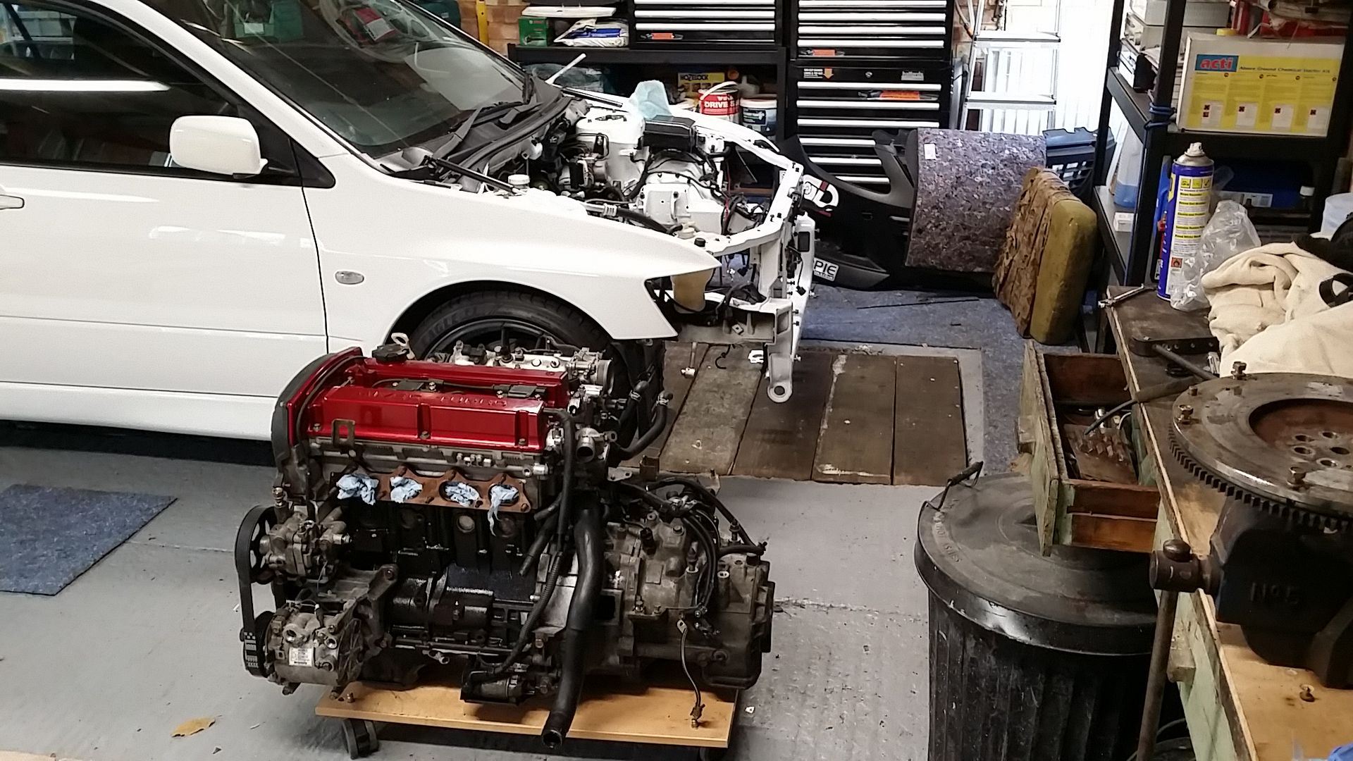

Started preparing the car for engine removal at the weekend
Gonna keep my turbo kit for now, it's too good to sell
All ready to be removed (I think)
Hoping to leave the transfer box on and just lower the subframe slightly, pretty sure it'll come forward enough to be lifted out?
Injectors arrived also :)
6
Managed to get the engine out today, pretty straight forward really...

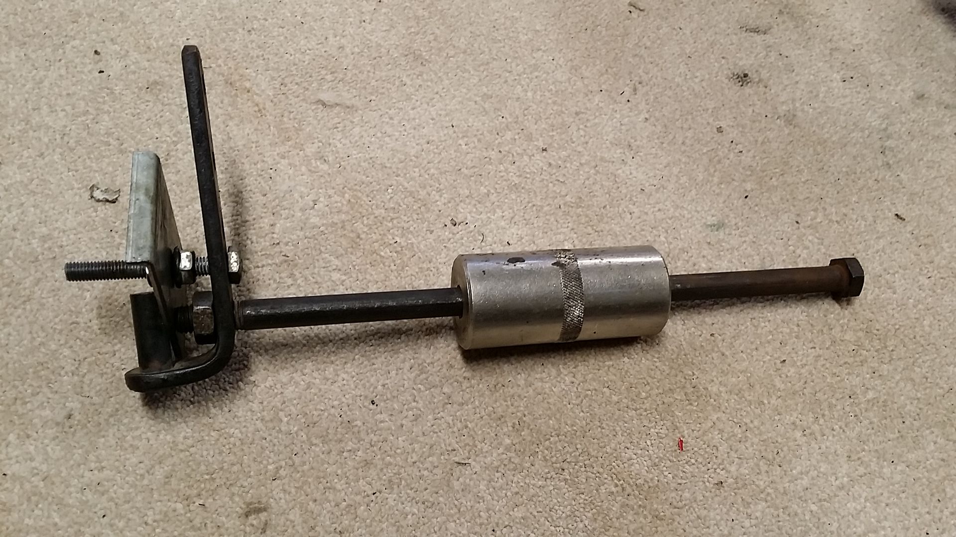

My home made slide hammer to get the output shaft out the transfer box lol

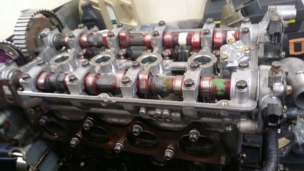

Stripped the engine down enough for it to go and get rebuilt...was worried about the release bearing in the gearbox after reading people have spent hours trying to get it released! But did it first time :)

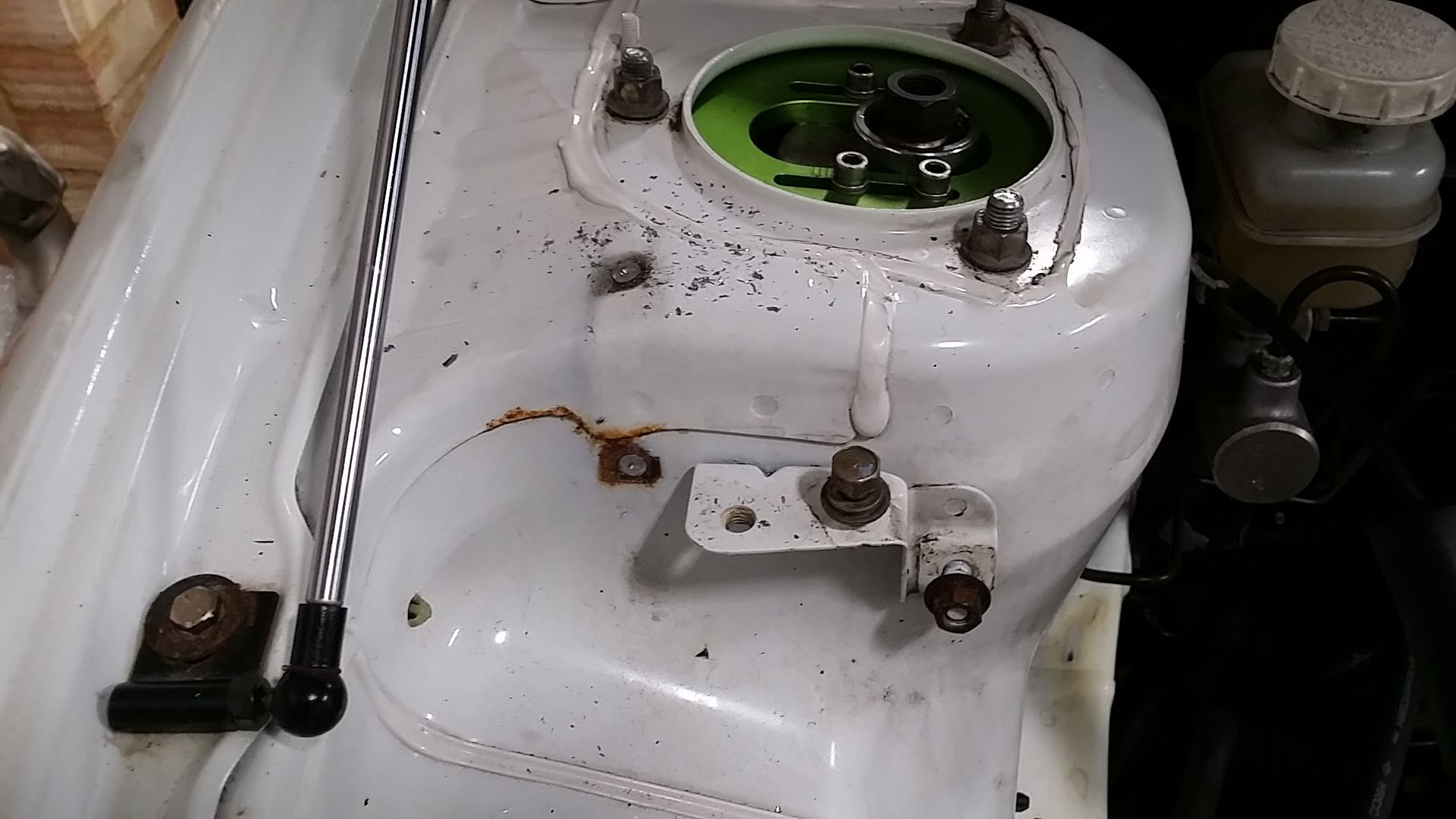

Spent Friday prepping the engine bay ready to be re-painted.
There was some rust starting to appear where the bonnet stay bracket was so I removed that
Front panel wasn't looking the best either
So I spent ages on the lower front panel getting it back to bare metal with various wire brushes on a drill, then went round the whole engine bay and rust treated everywhere and left it over night. Didn't get any pictures of this unfortunately :(

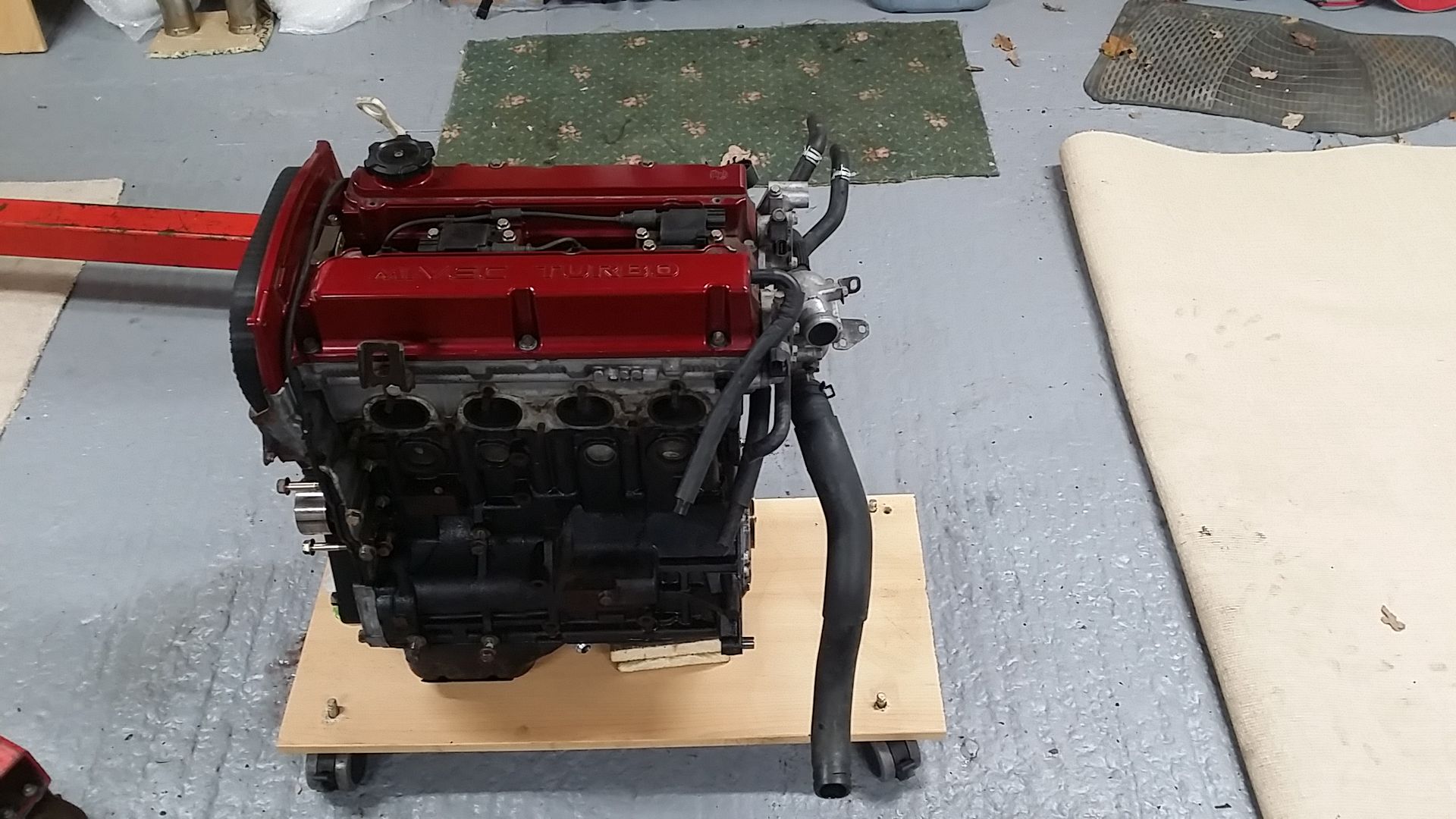

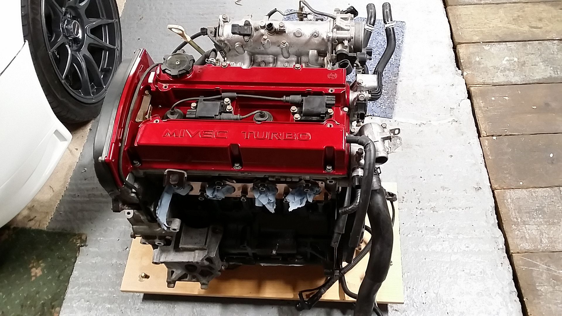

So I picked my engine up from Owen Developments today, they've done an awesome job and I'm very impressed with the quality of work :)
I got sent a couple of pics of it mostly built up
Back home
7
So spec now is
94mm billet crank
85.5mm CP pistons
Bridgeway 153mm I beam rods
Kelford 272 cams
Kiggly Beehive valve springs/titanium retainers
ARP main stud kit
HKS iridium spark plugs
HKS exhaust cam pulley
HKS 1.2mm headgasket
ACL race bearings
Balancer shaft deleted
ATI Super Damper crank pulley
Competition Clutch twin plate clutch and flywheel

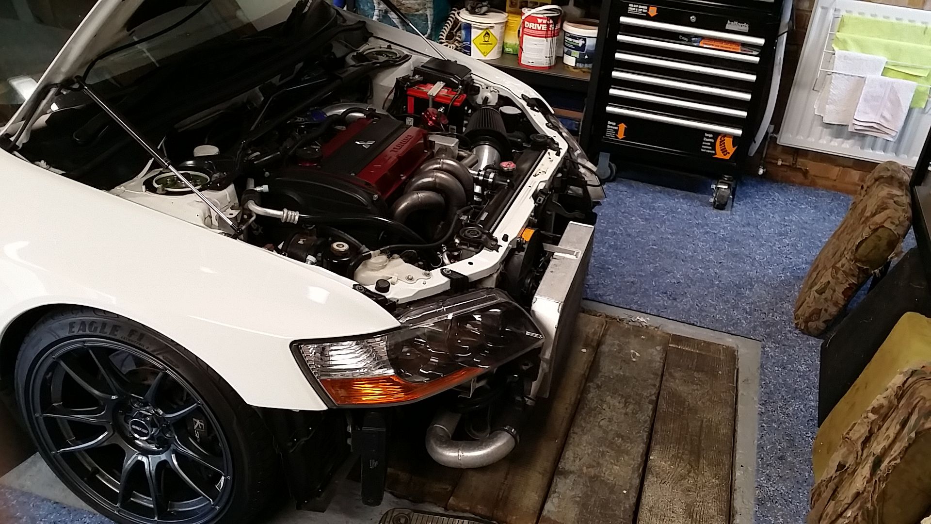

Got the gearbox and other little bits back on ready for it all to go back in the bay
Mounted on 3 mounts, transfer box on, shafts in and most of the wiring in place...took me a while to get it mounted on my own without scratching anything but got there in the end :)
Manifold/turbo back on
5
Looking good, I nearly text you yesterday when I saw the pictures saying I might pop round, but I went home and had a nap instead haha
Much left to do?
Haha, just the rads, intercooler etc then gotta run the new fuel lines, fit swirl pot and other fuel pump then do all the fluids.
