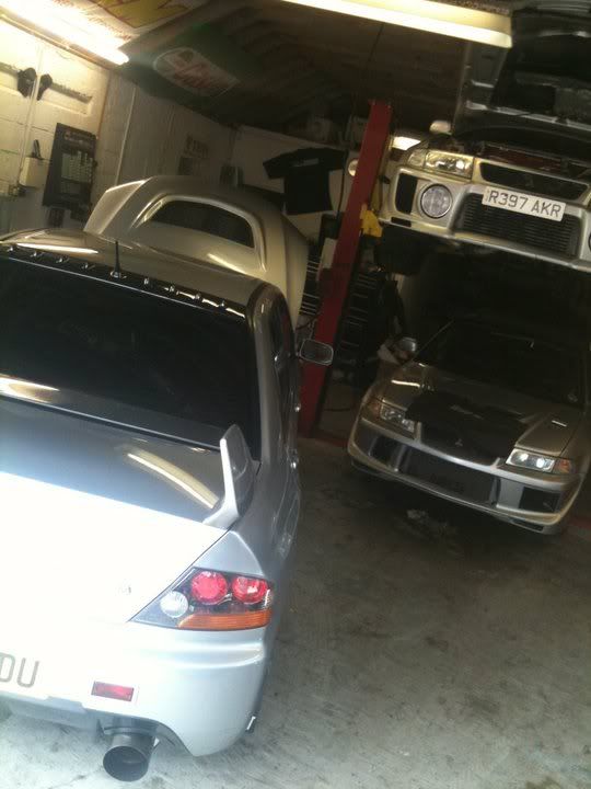

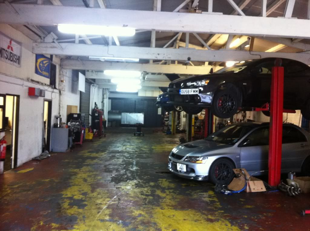

Just wanted say a big thank you to Team RG Rich/Pete/Dan for building the car and fitting on the T3 kit for us. Most of you guys wanted to see Non E85 results so this was the best time to show you what the MAP T3 setups did on UK Vpower.
Also a big thanks to Matt at TRL on mapping the car on so short notice as well as his customer friendly staff. I also met a few obsessed (I wont say who) MLR members there and was good to put a face to the MLR username :smthumbup

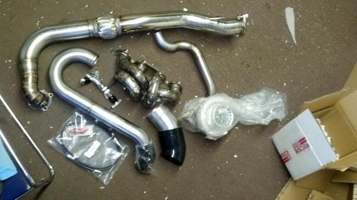

Map T3 kit

TRL
RG Garage

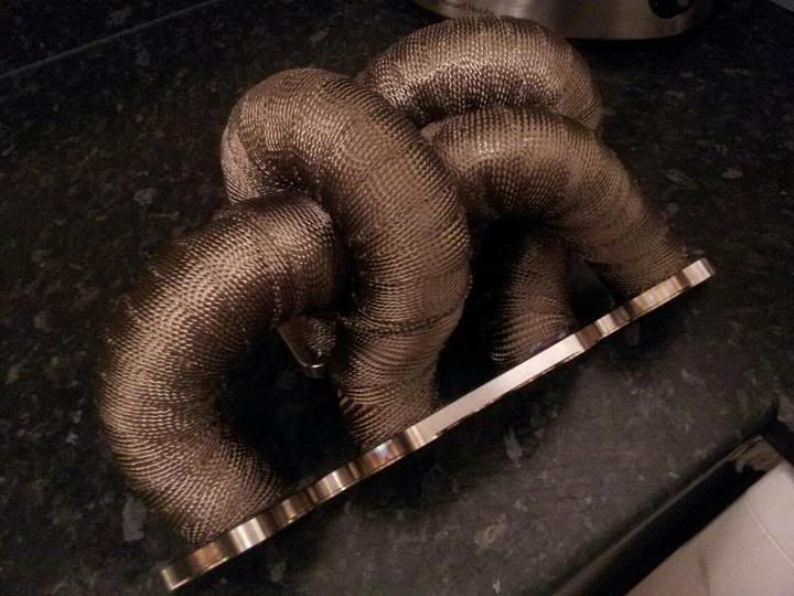

Turbo Install
Manifold Wrapped

Here is the kit currently on the car. Note they are for a 789 fitment we can do an elbow outlet but you will have to mod your DP for a 456. Price is also down to turbo choice.
T3 Setup
http://www.maperformance.com/map-complete-t3-turbo-kit-mitsubishi-evo-8-9-map-evo-t3k.html
Hot Parts Only
http://www.maperformance.com/maperf...-mitsubishi-evolution-8-9-map-evo-t3k-hp.html
T4 Twinscroll
http://www.maperformance.com/map-t4-twin-scroll-turbo-kit-mitsubishi-evo-8-9.html
VBand Top Mount
http://www.maperformance.com/map-st...nt-complete-turbo-kit-mitsubishi-evo-8-9.html
