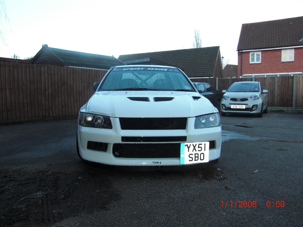

This is Chris's evo who used to work for us and helping him sell his car so here it is.
Evo 7 rs in white with aircon option (been deleted ) and mechanical centre diff
Imported and sold by DYC
Undersealed from first import
Y reg 2001
32000 miles ( around half in km )
11 months MOT
5 months tax
price £34995
Spec list below

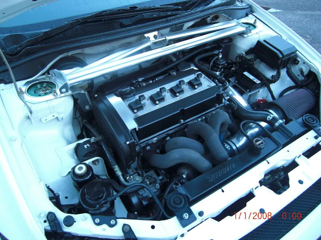

*APT built 2.3L stoker engine
*Mitsubishi 4g64 crank
*Crower rods
*Wiseco HD pistons
*ARP head studs
*ARP main studs
*Balance shaft delete kit

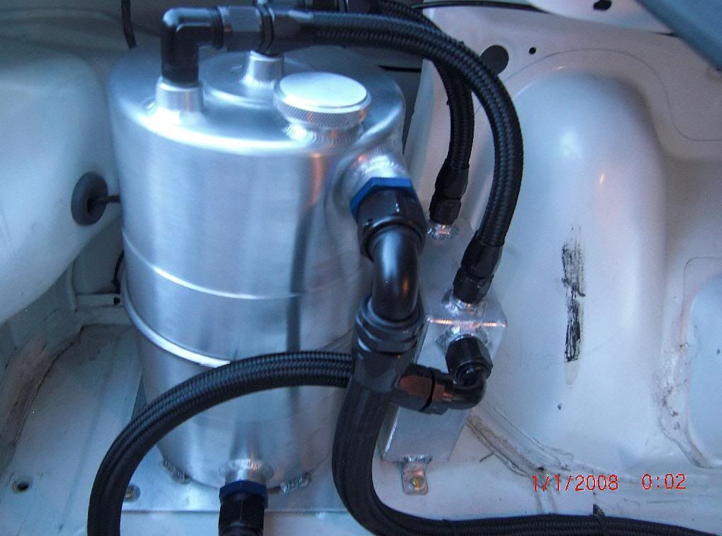

*25 row oil cooler mounted in original location on custom brackets with -10 aeroquip lines and aeroquip fittings
*Remote filter head with bigger filter than standard with -10 aeroquip lines and aeroquip fittings

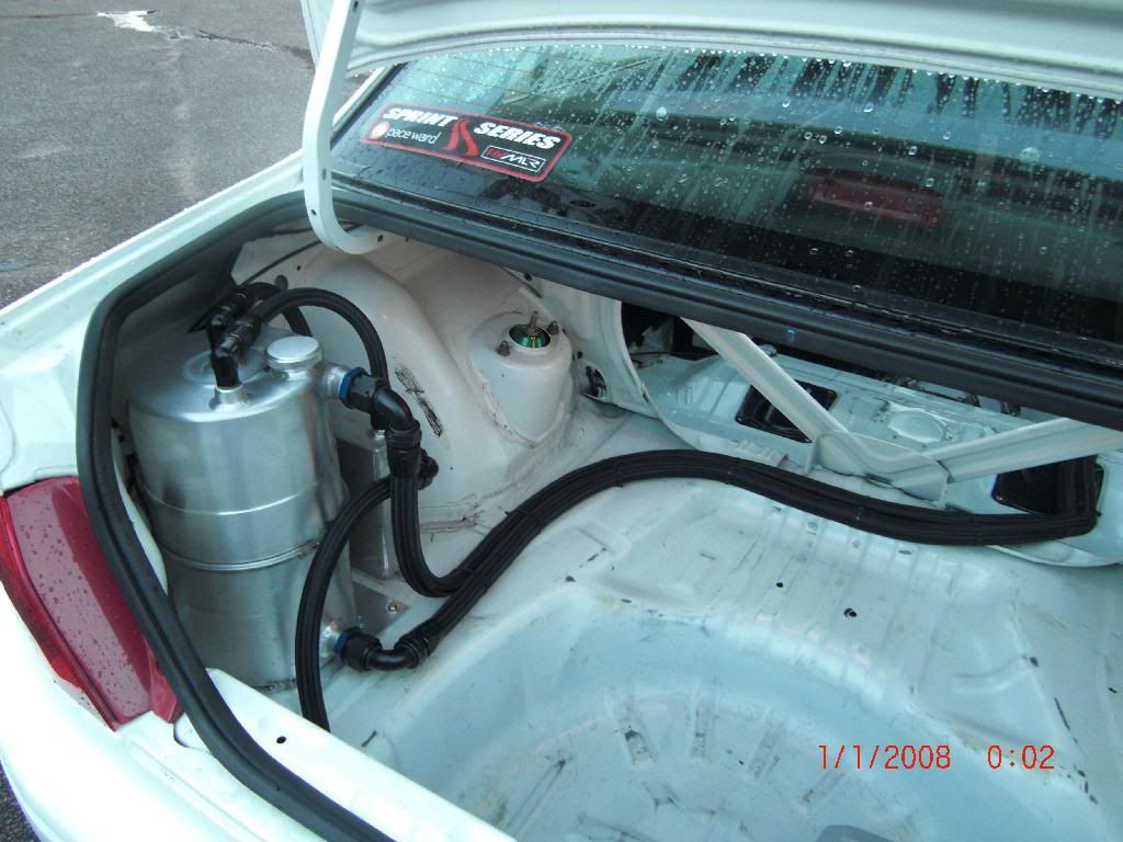

*APT dry sump kit with tank mounted in boot all aeroquip lines run under the car are in aeroquip metal hose with aeroquip fittings and any hoses in the car are in light weight aeroquip hose with black aeroquip fittings
*Catch tank with two -10 breathers from oil tank to catch tank and -12 vent hose from catch tank to under the car, all hoses in aeroquip light weight hose with black fittings
*New gates kevlar aux belt
*New gates cambelt
*New dry sump belt
*New Millers nano drive oil
Head
*Refreshed head
*Jun 272 cams
*Hks cam gears
*Brian crower springs and retainers
*Early rocker cover in crackle black with two -10 aeroquip breathers welded on
*Neverman catch tank with light weight aeroquip hose and black fittings in engine bay

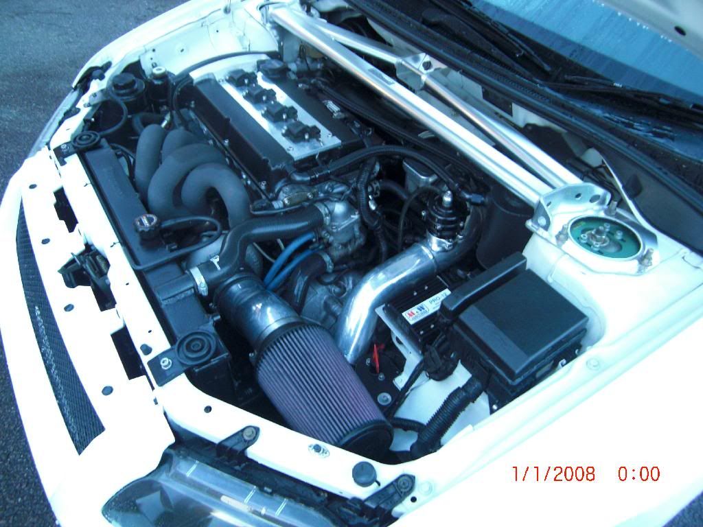

*Blitz boost controller with perrin control solenoid
*Motec m800 oe board with knock control board, launch, logging, flat shift, drive by wire,
(all features unlocked),10 position knob for launch control, oil pressure cut off, oil pressure oil temp fuel level sensor inputs
*motec shift light to show warming lights for knock control and low oil pressure cut
*4 bar map sensor
*Spark tech CID ignition with Norris designs coil plate
*R32 golf electronic throttle body
*Golf gti electronic throttle pedal on custom bracket

*Ross sport gt 35 hta turbo kit with zircoated manifold and exhaust housing
*Black tial wastegate
*Custom 3'' v band down pipe
*Buddy club racing light weight true 3'' exhaust with two silencer boxes
*Simons 3'' silenced decat pipe
*Ralliart exhaust rubbers
*Jmf custom drag inlet manifold painted black
*Ross sport 3'' intercooler pipes
*Ross sport 4'' intake pipe
*Black tial dump valve
*Ams intercooler
*Mishimoto evo 6 radiator
*Mishimoto radiator cap
*Custom radiator vent pipe
*Ralliart coolant overflow tank
*Ralliart low temp thermostat
*Ralliart titanium pedals
*Evo 6 silicone top radiator hose and evo 7 silicone lower radiator hose all in black
*4'' inlet long k&n air filter

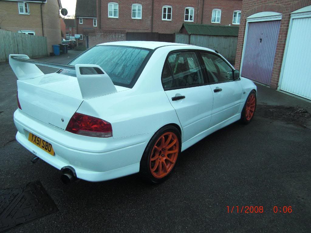

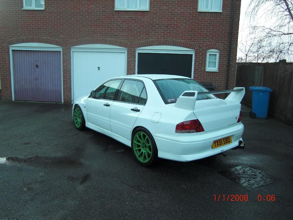

*Rota force drift wheels 9 * 18 (orange and green )
*255/40/18 yokahama advan ado8 tyres

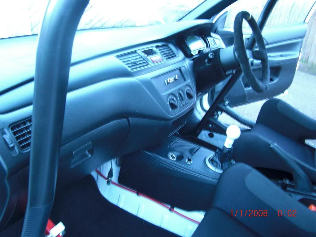

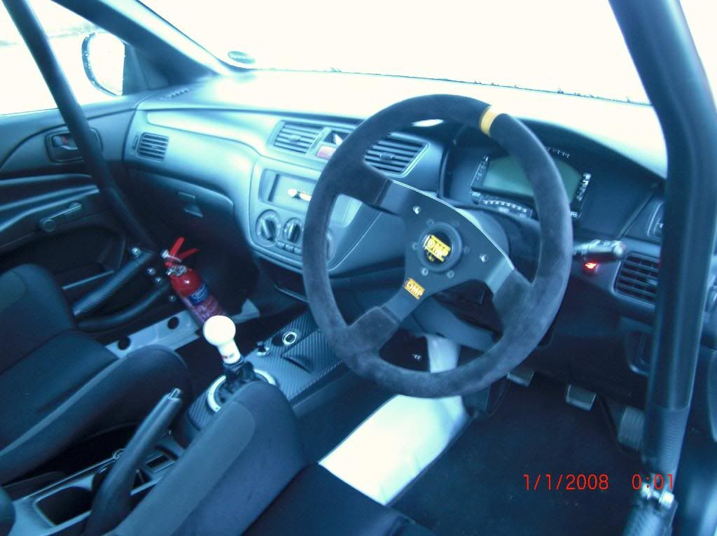

*Cobra seats
*Stroth harnesses
*Omp deep dish steering wheel
*Ralliart gear knob
*Safety devises bolt in cage
*Fia roll cage padding
*Stripped interior

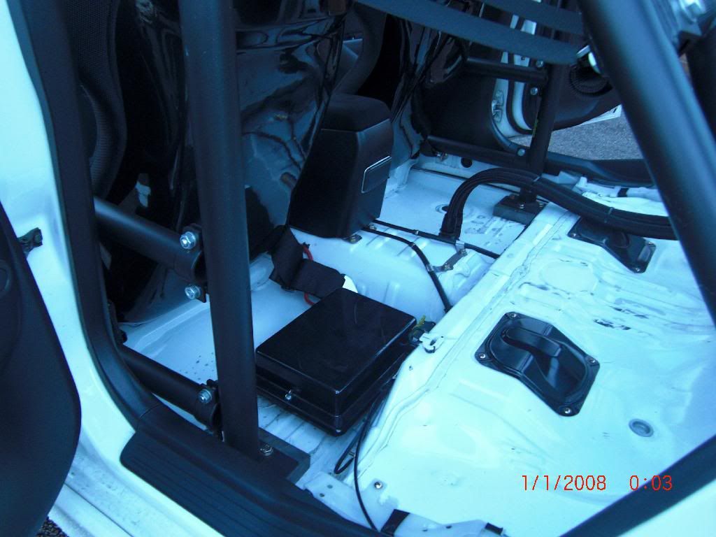

*Red top 30 battery in battery box behind passenger with cut off switch in engine bay and battery cables run through the car
*Aim dash displaying air temp, Oil pressure, Oil temp. Water temp, Battery voltage, fuel level with low fuel, main beam, indicator, battery voltage, water temp, oil pressure warning lights and staged shift lights
*Custom dash panel for mounting Aim dash
*Custom dash panel with boost controller mounted in
*Carbon wrapped interior pieces
*Hornet cat 1 alarm with fitting certificate
*flocked steering wheel surround
*Satin black painted dash trims

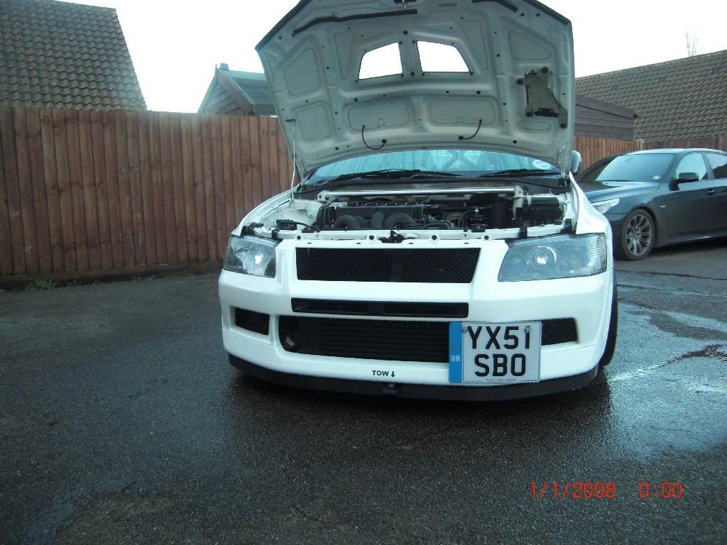

*Black accent pieces ( intercooler vent, door handles, spoiler blanks, mirrors )
*Carbon exhaust guard
*Ralliart stubby mirrors
*Custom carbon front splitter
*Black Fia tow straps front and rear
*De tangoed and blacked out headlights

Is that fuel lines dropping through the floor just behind the drivers seat? If so, is it normal to have them inside the cabin of the car?
3,371 Posts
What boost/power is this running?
Pretty much identical block and head spec to mine also running a 35.
gotta be 600+?
Mines [email protected] on std inlet manni.
this is a seriously cracking car!!
For anyone with the money wanting a totally sorted car should honestly look no further!
A right weapon all round with that whole spec.
glwts pal :smthumbup
could waste more trying to get near this spec :eek:
