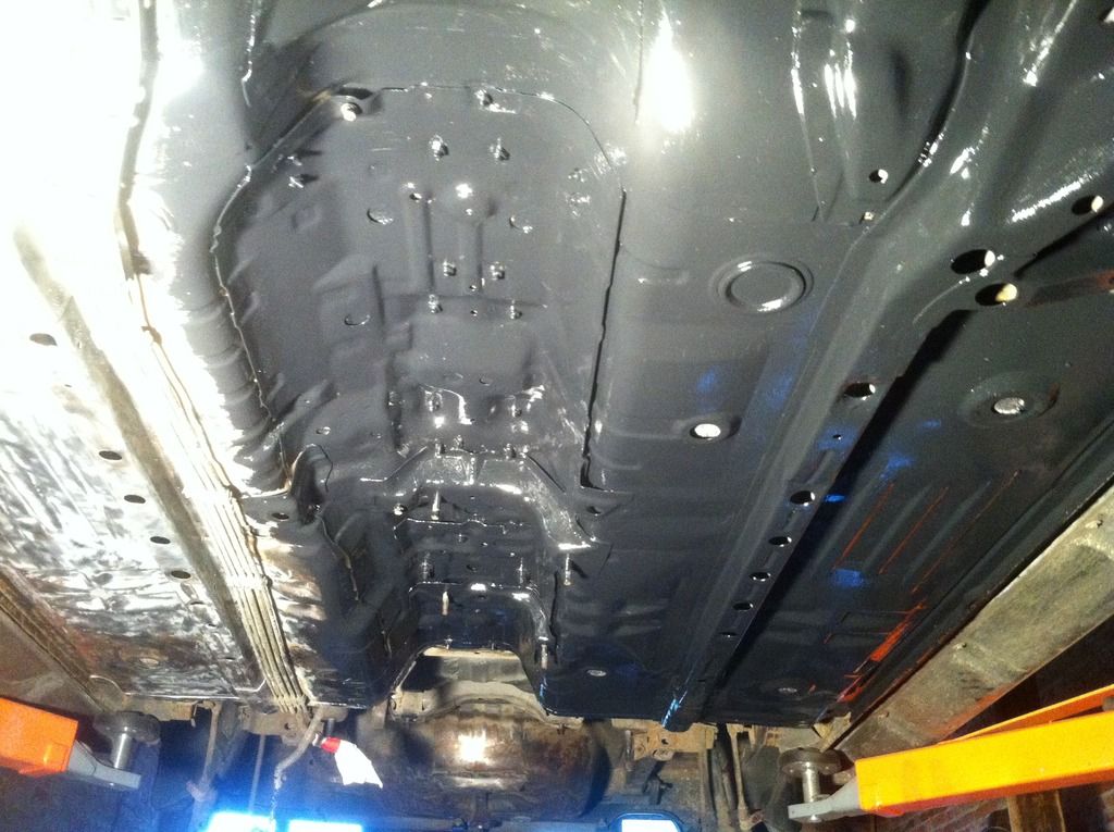

this is how 1 layer of korrux flat black looks like

Another update on the project.... I've been struggling to find the time I want/need to spend on the car, so decided to get a little help to push it along a little.
6 hours and just over 500kg of glass media later it looks like this !
Just need to tidy up some of the remaining small areas of the original seam sealer and stone guard that believe it or not blasting struggles to remove.
Would I go down this route again ? Probably not as I've spent hours clearing up the dust and debris :wallbang:
Hopefully further updates will see some serious progress and the car starting to look pretty again :smthumbup

Pretty certain I'm going to use Rust Bullet automotive , others have used it and recommend it . I'm going for spraying as I'm really after a decent finnish :smthumbup
I sprayed mine using a HVLP gun - dries hard as nails!
Make sure you get the RB Automotive and not the other as it's thinner so sprayed better without blocking up. Just make sure you follow the time scales religiously for recoats and topcoats.
