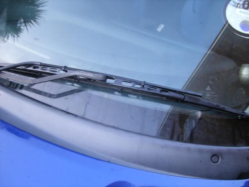

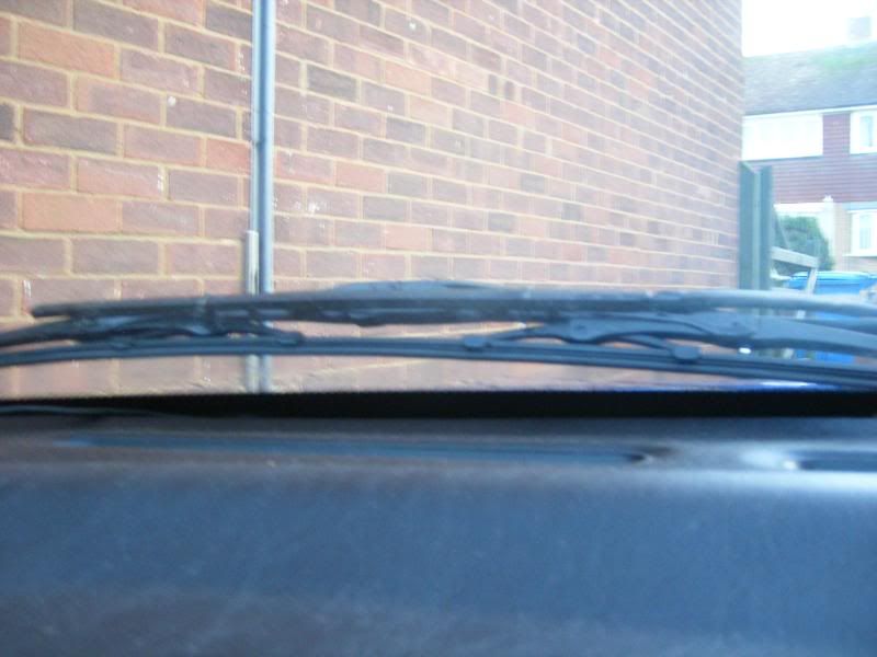

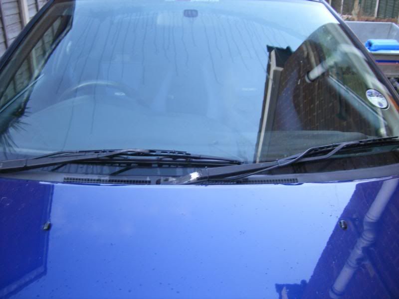

Scania R series washer jets on Evo 6
Was looking at the washer jets on my 6 this morning and decided they were **** poor, wifes leon has the fan jet ones but they wont fit. So i fitted these
all you need is a few black cable ties and about 20 spare minutes,
The water really soaks the screen enough to remove most annoying dirt.
Please excuse the leon in the photo i know its not :mitsi:

should have done a search mate - Volve S50 mist jets are a direct replacement and two can be yours for 11 quid from volvo part online

I like the washer mod a lot :)

Was this a kit or a DIY solution??? Interested in doing this myself... it's a really good idea. (My dad's peugot 405 company car had something like this many years ago!)

search ebay for volvo washer jets. you want the ones for the s40.
They are all the same parts numbers for pre 2001 models, 2002 onwards and 2004 onwards.
Checked it out tonight on a volvo online parts and the 3 different age cars listed same part numbers.

I fitted the Volvo V50 jets to my 6 (good tight fit) and it has improved the coverage a lot and is a mist.
However, I also have V50 (second car) and the washers on that are much better - think it's because the washer motor for the Evo is in the boot so there is a lot of frictional loss in the system whereas the Volvo bottle and motor is under the bonnet.
Am thinking of installing a new motor under the bonnet of the Evo so end up with a two pump system.

they dont work with the wiper blades, i still have the clips and will try on my next wiper set
