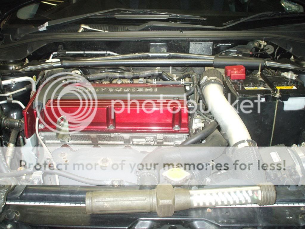

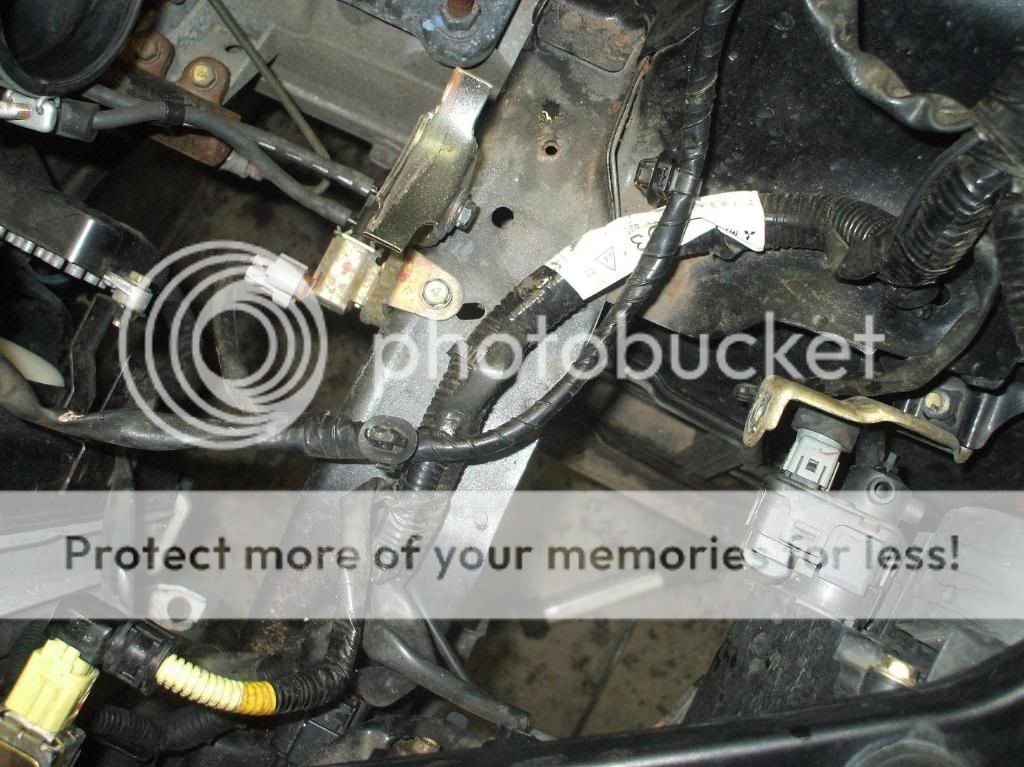

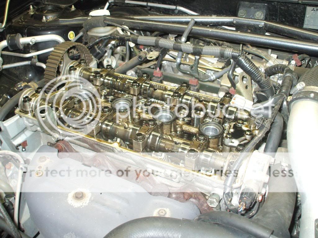

fitted a few mods on sunday in my mates garage before my ECUTEK re-map @ APT i had done yesterday.
i had a near standard 260 at last years marham 30-130 so had to beat my times this year.

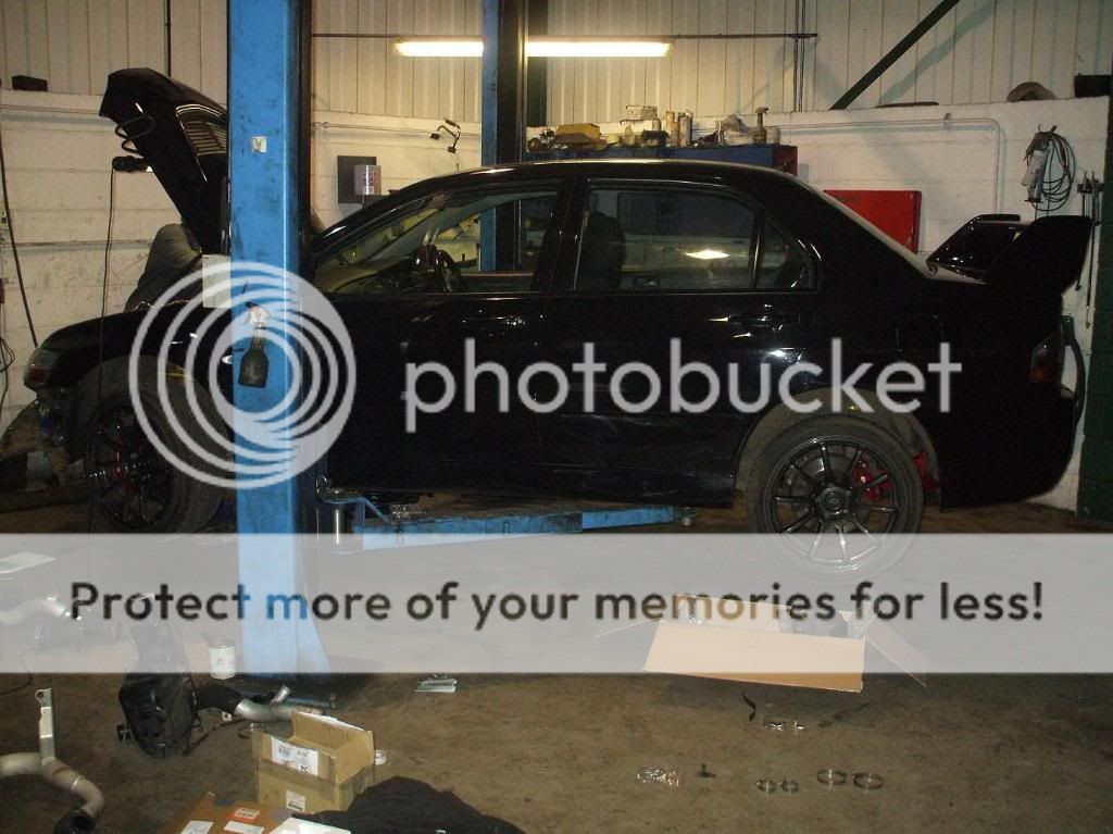

fitted myself on sunday:
cams
cambelt
10.5t housing
turbo elbow
hardpipe kit
turbosmart bov
already fitted:
3" tsl exhaust
hks induction kit
de-cat etc etc
heres a few pics:) they are not the best but hope you enjoy

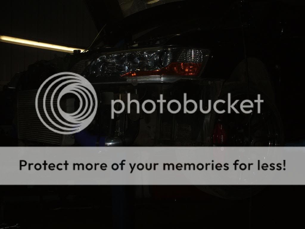

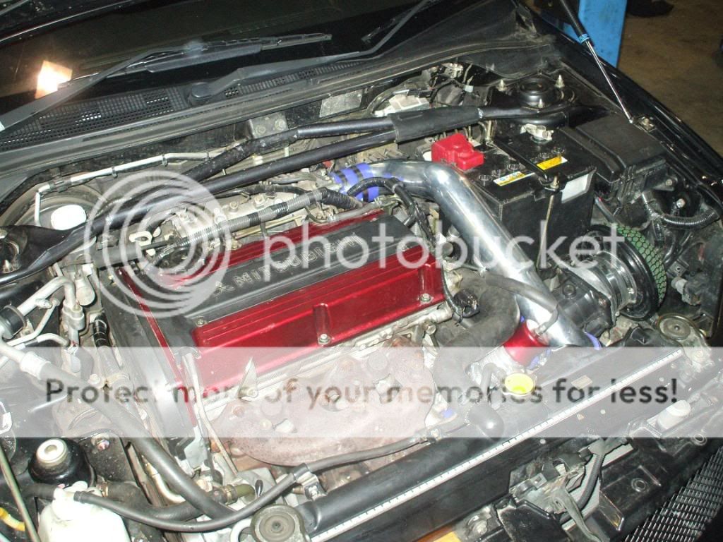

thought i would remove intercoller spray bottle whilst im there:mhihi:

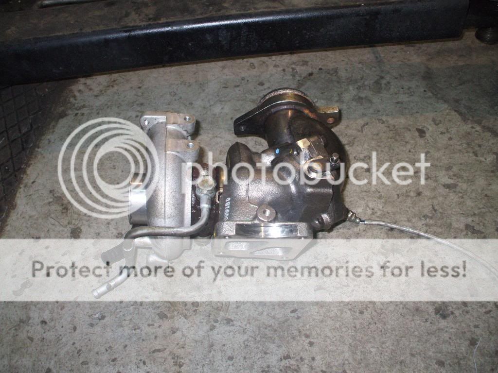

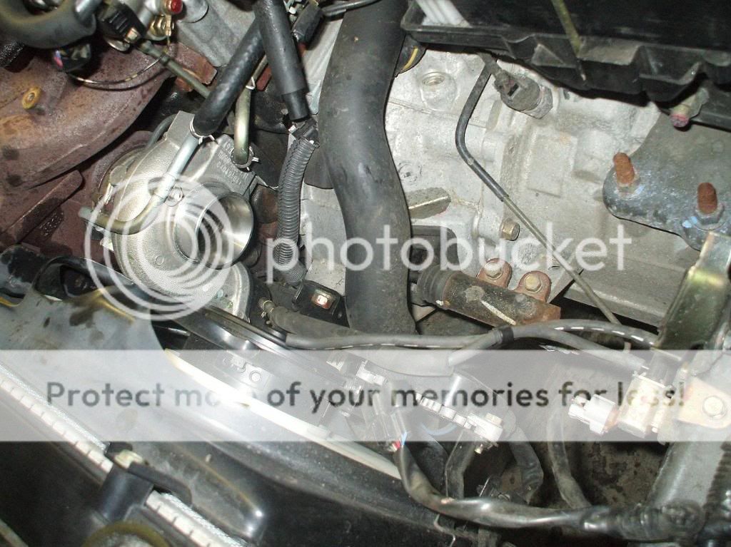

then turbo off to replace with 10.5t housing:D

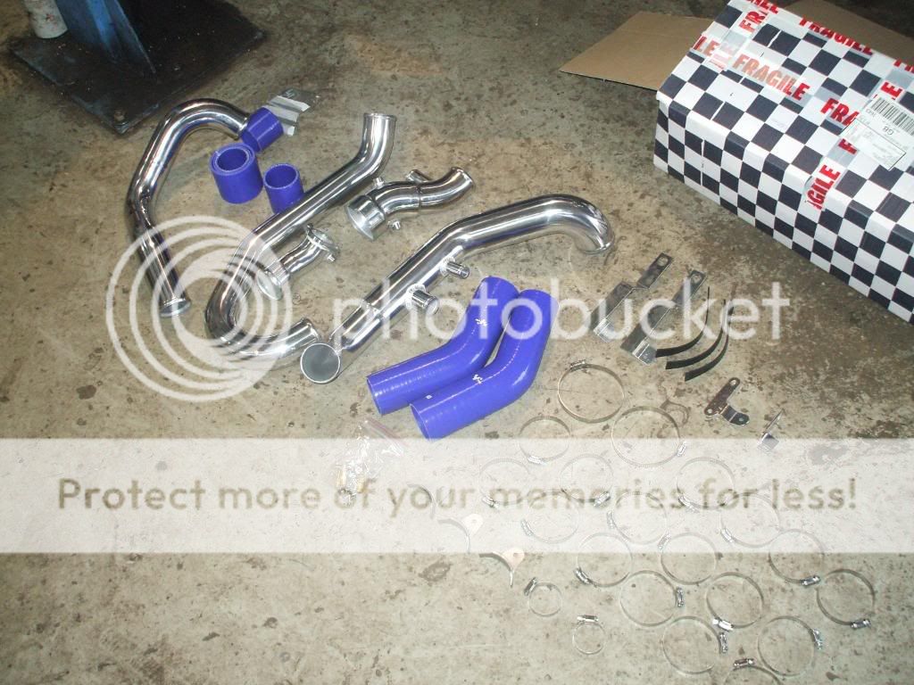

then i tought i would try a KTR hard pipe kit, for what they cost i reccomend them:smthumbup

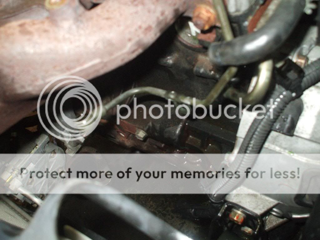

Is it just me or is the turbosmart dv plumbed in wrong? Looks like the pressurised side from the top intercooler pipe goes into the side port of the dv where i thought it should attatch to the bottom of the dv.
1,639 Posts
pipes are all in correct place, sounds awsome at hight boost:D but yes you are right in a way, its not positioned in the right place, i needs positioning the other side of the rad hose so its no so close to rad fan:blush:

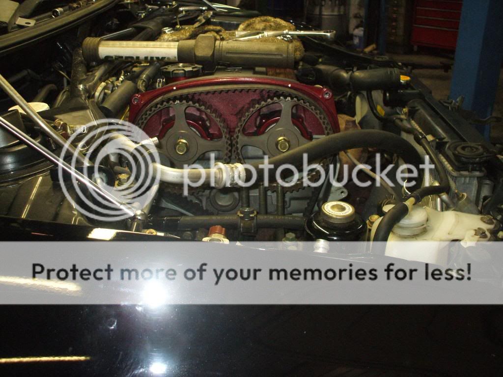

how many miles did it have before cambelt? what condition was it?...amazing things you can do with a ramp
belt wasn't due for another 10000, but i fitted new cams so thought i might aswell do the whole lot at the same time;)

any issues the the ktr kit? i've got one to fit to my 260 when the i get the time:rotz:
spot on build quality for the price you pay, and much larger than 260 pipes, but 260's do really need a smaller battery fitted, i modded my battery tray a bit to make it fit, but it is touching:eek:
