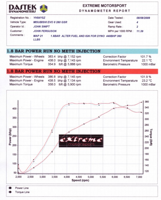

CBRD BBK turbo results:

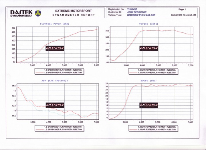

358lbft and 438hp. = +5lbft, +48hp over my 8MR turbo

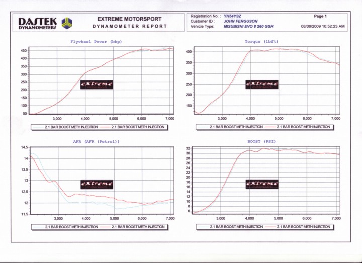

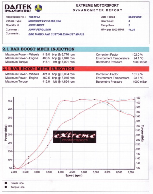

415lbft and 463hp at 30psi peak down to 27psi. = +12lbft, + 50hp.
My car is an Evo 8 260 with standard rods/pistons and ECU. Mods are:
255 fuel pump
RC750 injectors
BBK full turbo
3" Modular downpipe
Sports cat
3" cat back exhaust
APS dump valve
NGK BR8ES plugs
AEM intake
HKS 272 cams
APS intercooler
AMS lower intercooler pipe
AEM water/meth injection
Firstly I'd like to say this turbo only takes 200 to 300rpm longer to spool up than my previous 8MR spec turbo. There is no surge in any gear and only a very slight surge at part throttle in 5th (less than the stock turbo). Also my car has never produced big torque on the dyno, always a bit less than expected.
I tuned the car on the road with Ecuflash and reckoned it made 380lbft and 455hp at 24 to 25psi of boost to redline with no more than 3 counts of knock. This was done in the cooler weather a few weeks ago but I noticed over the last few days knock counts had increased slightly. On the first dyno run I was surprised that the car made exactly what was predicted even though there was a knock count of 7 at 6000rpm. On the second run there was more knock all over the power band and power and torque dropped. The car proved it could make great power on a single run but as I'm running a stock block I'd rather it mapped with some safety in mind so some timing was pulled to eliminate knock over 3 counts. Also, I never mapped the car on the road with 4 passengers while going up hill so I'm happy with a conservative 358lbft and 438hp.
We then flicked the magic switch that turns on the water/meth injection and changes maps in the ECU. I hadn't fully tuned this setting on the road but the knock warning light seldom came on. On the first dyno run there was a fair bit of knock so we took some timing out and power went up. The result was 415lbft and 463hp. I think I'll fine tune this on the road as I only turn on the water/meth on a straight road with no more than one passenger in the car. A tank full of water/meth doesn't last very long so I'm limited to how long I can use it. I think there is a little more power to be had here.

On the graphs below I've noticed the dyno's boost reading is a couple PSI higher than what my AVCR and Evoscan are saying.

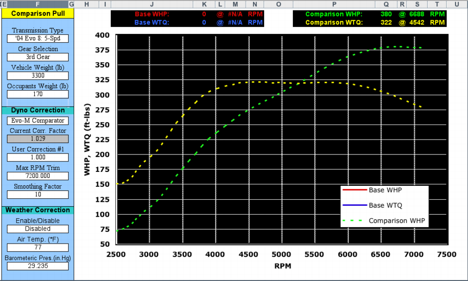

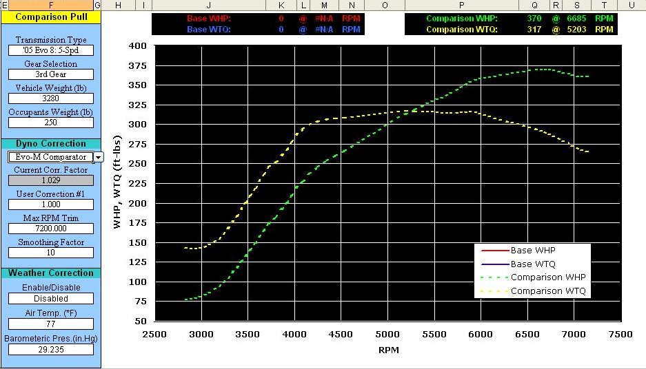

The tune on pump fuel reads 24 to 25psi on my AVCR on the road and dyno. I don't know why the dyno graph is showing higher boost.
I've heard knock in the cabin before with a knock count of 9. I think 15 would be very audible with det cans. The knock sensor can be desensitised in Ecuflash but I'm not about to mess with that, especially running stock bottom end.
I've spoken to Scheides on EvoM about my results. He has a similar set up but with ported manifolds, head and Kelford cams. We make about the same power at 24psi
but he makes 20hp more than me at high boost. Check out the graphs below. They are from Evoscan road logs at 24to25psi boost. This is where Virtual Dyno Room comes in very useful. I think it is a far better tool than comparing results from various real dynos.
Scheides also pointed out that I'm using a sports cat which might loose me 10hp.
My results at 24-25psi
Scheides results at 24-25psi
